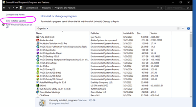

So it seems you're on the primary Uninstall or change a program window vs. the "view installed updates" window of the Control Panel and are seeing ArcGIS Pro 3.0 application.  You have to go one more window deep to see the installed updates to access the ArcGIS Pro 3.0.1 patch.  This link will show you how to get to the viewed installed updates window.
With regard to your question - as this is the primary application window for programs, you will see ArcGIS Pro 3.0.36056 and not 3.0.1 (that's the patch one more window deep).  The 36056 number is the final ArcGIS Pro 3.0 build release candidate from the development team.  It's just a number that increments up internally on new builds, alpha candidates, beta candidates and release candidates.

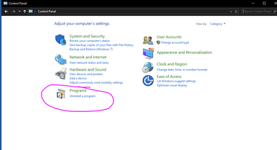

Clicked the Windows buttona nd preformed a search for control panel opening the dialog below.
Then Click on the "Programs - Uninstall a program"
Then Left hand column click on "View installed updates" and uninstalled the Patch 3.3.1 for myself.

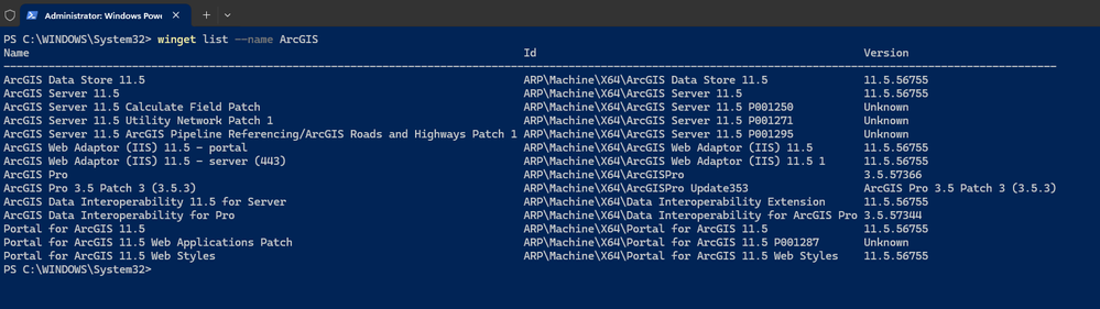

Correct in Windows 11 ArcGIS software patches and updates are no longer available via the control panel.
They can be listed with Windows Package Manager - WinGet command in Powershell
WinGet list --name ArcGIS
 So it is possible to remove a specific patches using the uninstall option
e.g. WinGet uninstall --name "ArcGIS Pro 3.5 Patch 3 (3.5.3)"
