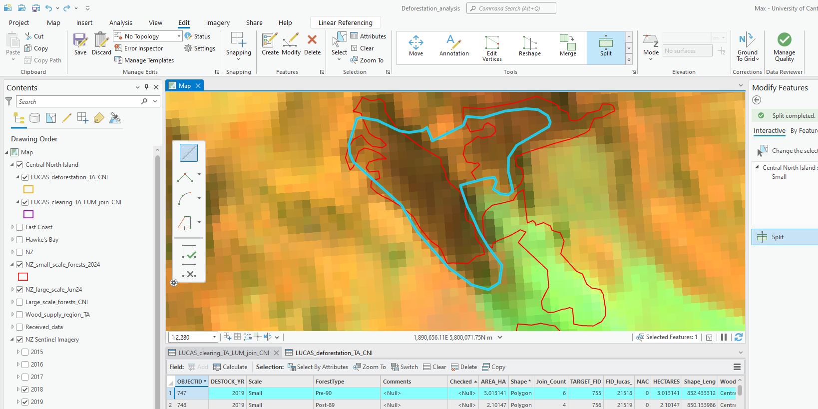

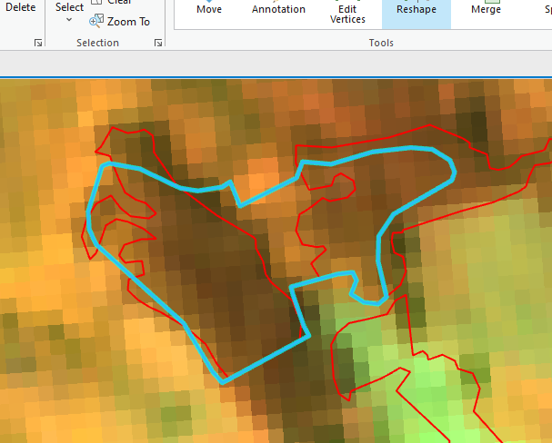

When I reshape a selected polygon, the reshape tool reshapes the selected polygon and unselected polygons. I have cleared everything, restarted the app, and it still does this. It doesn't occur when I split the polygon, only reshaping. Both polygons flash after reshaping, even though the red one is not selected.
Before and after screenshots.

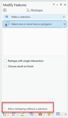

Is "Allow reshaping without a selection" checked on at the bottom of the tool pane?
More info about this setting in the doc, see step 4: https://pro.arcgis.com/en/pro-app/latest/help/editing/reshape-a-feature.htm
