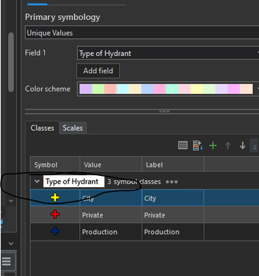

2: open the symbology pane for that layer. Change the name above the symbols.
