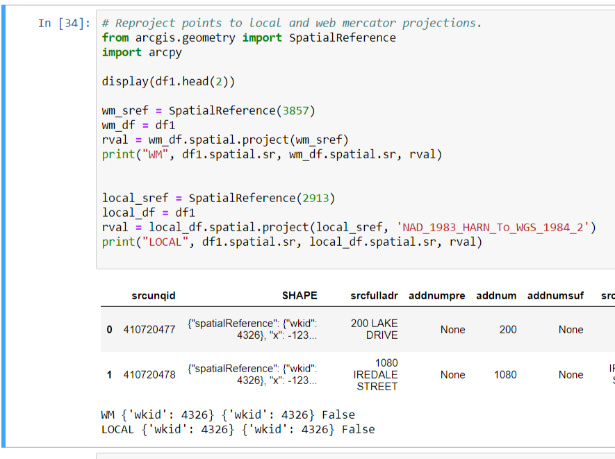

I am using a Notebook in ArcPro 2.7 to process some data using GeoAccessor dataframes. Works great until I try to reproject the df before the final step, writing it to feature classes.
I worked beyond annoying ERROR 9999 messages, by passing in a SpatialReference object instead of a WKT string.
I get no indication of errors now! Unfortunately nothing happens, the "project" method is supposed to do an "inplace" conversion but the conversion does not happen. The method returns "False" but there is no documentation on whether that's good or bad or what happened.

I figured out that I can pass an integer as the WKID into project instead of a SpatialReference.
Also I realized I have to use the copy method on dataframes else I am only creating reference and not a copy of the data. I think it should look like this, the first one works and the second is grinding along; I think the transformation string might be wrong but no feedback, just processor cycles burning. I'll go for coffee, a a watched GIS script never boils.
wm_df = df1.copy()
wm_df.spatial.project(3857)
local_df = df1.copy()
local_df.spatial.project(2913, 'NAD_1983_HARN_To_WGS_1984_2')

I ran the same code without the transformation string and it finishes but of course, the results are off. Not surprised. I have to know what magic string to use for the transformation, it is undocumented. I pulled that one from the Project tool in Arc. For now I will use arcpy, save the DF to a feature class in WGS84 and then run the arcpy version.

The original data is in a table with lat/lon columns. I pull that into a dataframe and then convert the columns into geometry. I might be able to reproject then too but my desired output will be in both WM for web and the local projection (with transformation) for an enterprise GDB so I still have to project it.
This time out I am taking Dan's advice (almost always the right path) and using the arcpy reproject and in a few months when the data is updated and we're at ArcPro 2.8 I will try project() method again.
I bet it would work today if I know what string to put in the transform parameter but I've had enough for today.
