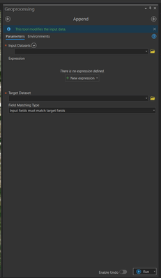

Have you considered creating a new feature class with the fields in the desired order and then using the "append (data management tools)" to populate the new feature class with your existing data? If you name the fields the same it should easily populate all the data, or if you use different field names with the new feature class, make sure you use the tools field matching type parameters to ensure all desired data is carried over.
