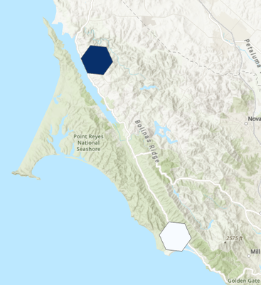

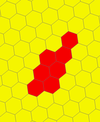

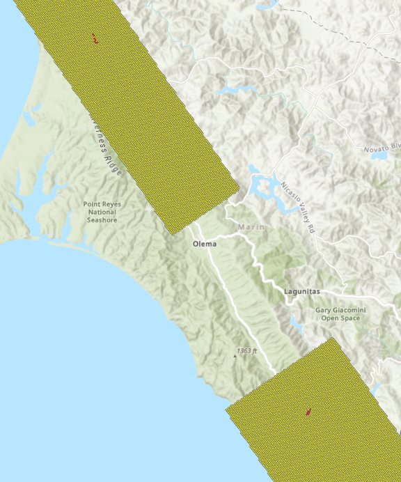

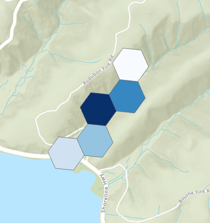

Image #1 shows a point layer being aggregated into hexagons. I am totally zoomed out in this imagine. Image #2 shows what happens when I zoom into  Image #1. This is what I hope to apply to my hexagon grid, which is in Image #3 and #4.
Image #1 (zoomed out binned point layer)
Image #2 (zoomed in binned point layer)
Image #3 (zoomed out hexagon grid)
Image #4 (zoomed in hexagon grid)
As you can see, the zoomed-out hexagon grid in Image #3 isn't as very helpful. I want the hexagons to not stay microscopic, but to merge together to show general symbolized hexagons, and then when you zoom in, you get more detailed hexagons/information.

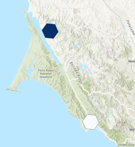

EKandD
Here is an example of what I am trying to make my hexagons do:
