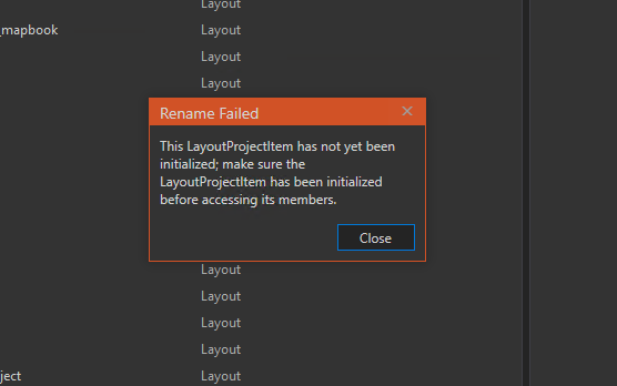

When renaming layouts and maps I always either get an error saying "Object Reference not set to an instance of an object" or the error in the image below. This has going on for a while and I'd be surprised if the devs were not aware of it.
Any Ideas what the problem is?

This is marked as ArcGIS Pro... but I have tried renaming by right-clicking on the layout name in Catalog and I have had no issues with existing or new layouts.
Is your situation different?
TonyDaSilva1
You will probably have to recreate it under real world circumstances, with dataframes and content. I have multiple dataframes and lots of content. I usually copy a layout figure and map object, rename them and start the next map from there to save time.

sounds like it is having a hard time catching up (that … has not been initialized... line)

Are you renaming maps and layouts from an imported mxd?
We have a known issue for this.
[BUG-000116427: An error occurs when renaming a layout from the Catalog pane in ArcGIS Pro.]
Listed workarounds:
  1. From the Catalog pane, right-click the layout and click Open.
  2. From the Contents pane, double-click the layout to rename.
