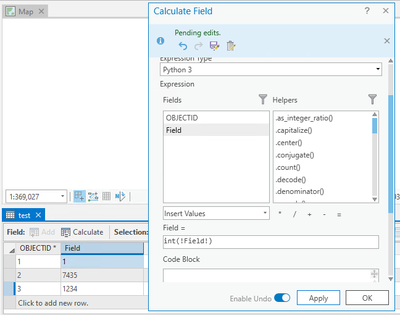

This thread popped up in my activity log today. You can do the same calculation in pro as I described above or use the int() function :
 I guess the int() function would have worked originally too....
