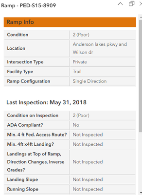

CJCowardin
Trying to configure a pop-up to remove all of the fields with no data since the list is very long.  I tried using IsEmpty but they are still there.  Any help is appreciated.

I have a solution that I've repurposed quite a few times. Here's an Arcade expression where the return is an HTML table that will include only attributes that have a value present. You'll have to switch out the attributes to match your own.

Here's what the result looks like (note that I also used one of the attributes, Condition, to determine the background color of the header:

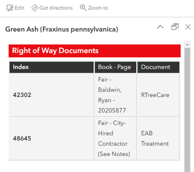

AdamGebhart
@ZachBodenner
Hi.  Do you know how to get the table result to be displayed horizontally to look more like this?
I'm trying to figure out how to do the horizontal display and remove the blank/null lines ('na' above) so that only populated records are returned.  My feature class has fields (index, book, page, imageURL) for documents one thru four.  Sometimes only doc1 is populated, sometimes it's only doc2 and so on.

AdamGebhart
Thanks @ZachBodenner .  I'll try out your element with my stuff this afternoon.
In case this helps answer your questions, I have a map service referencing a polygon feature class that shows source document locations for right-of-way easements, acquisitions, etc.  We have up to four possible documents, and like I said in the previous post, not all shapes have all four document fields (book type, book #, page #, imageURL) populated.  In fact, few do out of 2,000+ features.
Below is what my html table looks like in the Text element.  Essentially, book1 doc fields are the first line and the fields are referenced via expressions 0 thru 3.  Book2 doc fields are line 2 and expressions 4 thru 7.  I'll always be pointing to an expression (based on field values) to populate the table rows instead of directly displaying the values from the feature class.
ZachBodenner
MVP Regular Contributor
Ah okay so your data is like, index1, book1, page1, doc1, index2, book2, page2, doc2, etc? You have a finite number of possible documents?
If that's the case your situation gets a little simpler because you don't actually need to loop through anything.
Essentially you could do this instead:

If this is the case, you can basically set up your table manually since you know the maximum number of rows possible.

AdamGebhart
@ZachBodenner
Thanks again.  I'm moving in the right direction.  Two more things though.
1) In place of the field names I need to reference expressions that I've created to better display the information.  I haven't been able to get the syntax right - do you know how to do that?  For instance, in the doc1 variables I need...
i1 = expression/expr0 (instead of $feature.index1)
b1 = expression/expr1 (instead of $feature.book1)
Etc.  I've tried $expression/expr0, ${expression/exp0}, {expression/exp0} and the code won't run.  I can add these expressions as variables in the element but that will add A LOT of code that I don't want in it if I don't need it there.
2) Any idea how to remove the white space between the header (red) and title row (dark gray) so that it looks like the image in first my post from today?
ZachBodenner
As to point 2, you could probably just change the HTML away from an H3 tag and just create a new table row with only one column (<td>)
As to the first, Arcade Elements in the popup can't reference the expressions you've already written, at least as far as I know. You would have to include those in the Arcade elements itself.
