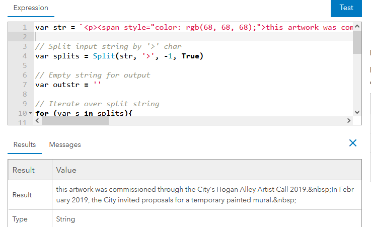

It's not terribly elegant, but you can do this with a few nested loops and some splitting and searching.
var str = your-string-attribute
// Split input string by '>' char
var splits = Split(str, '>', -1, True)
// Empty string for output
var outstr = ''
// Iterate over split string
for (var s in splits){
    var substr = splits[s]
    // Find items not beginning w/ '<', i.e., not HTML tags
    if (Left(substr, 1) != '<'){
        // Check if string ends w/ HTML tag
        var i = Find('<', substr)
        // Trim HTML tag from end if present
        if (i != -1){
            substr = Left(substr, i)
        outstr += substr
outstr
And for the proof:
You'll notice the "&nbsp;" does not get removed, but we were only looking for HTML tags. These could easily be stripped out with a Replace function, though. Or rather than stripping them out, replacing them with '\n'.
- Josh Carlson

OM
Can't thank you enough for solving this.  It worked great.
Olga
