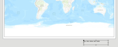

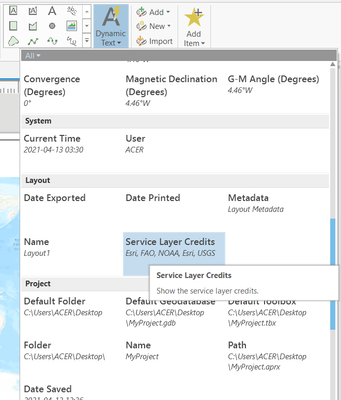

JScottLane
Nope - this example is ArcMap, not Pro. In other solutions the description is just plain wrong. Here is the answer in ArcPro:
  1. Do NOT activate the layout, but select it (you'll see drag handles at the corners)
  2. Click on "Map Frame" at the top of the window.
  3. Click on "Dynamic Text" dialogue box (you cannot imagine my joy at seeing this after following bad instructions several times)
  4. Scroll down a long list to get to a group called "Layer Credits" and select "Service Layer Credits."
  5. Draw a box anywhere on the layout.
  6. Then, with unrepressed joy overfilling your psyche, move that text box off to the side. Note: this does not in any way suggest that I am supporting not accurately crediting source data - always credit your source layer when distributing content.

Dynamic Text> Click and pull to the side!
JayantaPoddar
MVP Alum
It is also similar to ArcMap. You should be able to move the Service Layer Credits outside the Map Layout.
1. Go to the Insert tab
2. Click on Dynamic Text
3. Scroll down and click Service Layer Credits (under Layout header).
4. Select the Service Layer Credits on the Map Layout, if required. You should be able to move the service layer credits now.
