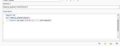

While using it in this setup here:
Hope that helps!
