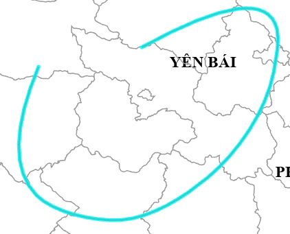

I use MapView.FlashFeature(SelectionSet) to flash some features. But when flash, it display a cyan overlay to my feature. How to remove this? Or another way to flash/blink features?
I removed FeatureLayer's SelectionColor of FeatureLayer, set UseSelectionSymbol to false. In SelectionOptions i set SelectionColor to NoColor, set ShowSelectionGraphic to false. But the cyan overlay still display when flash.

In ArcGIS Pro, the MapView.FlashFeature(SelectionSet) method does not allow you to change the flash color directly — it always uses the default ArcGIS Pro flash color (cyan) and duration defined in the application settings.
If you want to change the color of selected features (or the flash effect)...this changes the color for all selections in the project:
Go to Project > Options > Selection.
Under Selection color, choose your desired color, in this case transparent.
Click OK.
MinhHoangf
Thanks for your answer. But when i change Color in Project>Options>Selection to red, the color of selected feature change to red, but flash color still cyan. So i guess Flash will always use cyan, and not relate to Selection Color.
