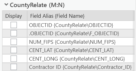

I related a map layer to a standalone table and want to get a pop-up that includes data from both. This is working for the most part, but text data from the standalone table isn't popping up as an option, only numeric data. i.e. I can choose to display a Field that states '5', but not one that says 'ABC'. Has anyone had this happen before? Do you know why/how to get all of the fields to show, not just the numeric one?
This is what shows under the Relate in the Configure Pop-up Window:

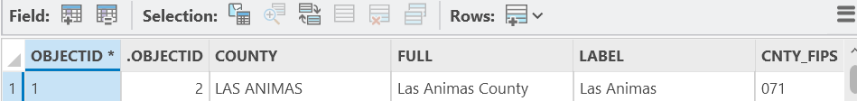

And this is what the Standalone table looks like:
So yeah, only the numbers are options (except CNTY_FIPS, which is okay). Does anyone know why?

Some pop up elements will only support numeric values when working with related data.
This is because it will do a statistical aggregation e.g. count or sum, that doesn't work for other field types.
E.g. adding a chart or field attribute.
You can show related data using a related records element. It'll show a list of related data.
You can add an arcade element or text element with arcade expressions, and drill down into your related data using featuresets.
