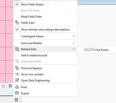

7) But the method from step 3 doesn't work - if I got to Table>Related Data>Click on the Points table - the table does show in the dropdown but when you click on it nothing happens. In the GDB version (i.e. in step 3), the points table opens and has the related records selected. In the Feature Layer version the table just doesn't open and the related points do not get selected.

  4. Click the three-line (hamburger) menu in the attribute table and choose "Show Related Data."
  5. Click on the listed related table to view related records.
  6. Nothing will happen

If I follow your workflow I don't see a "Show Related Data" option when I click on the hamburger, I can hover  over "Related data" to expand and then click on the related table there - at which point nothing happens.
