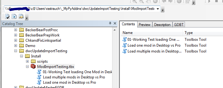

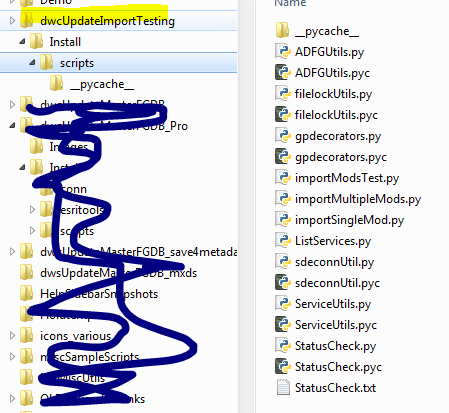

EDIT:  Adding pics to help show the issue.  All are looking at the same path.  .py files and tools in .tbx were deleted using ArcCatalog .... after the folder/toolbox had been viewed once (or twice) in Pro....but even those tools that have been deleted (including the .py) that were never run in Pro yet can start up the gui for user input (although it will fail with missing script error).    I would like the list of tools to be refreshed in Pro, if they have been physically removed from the toolbox.
File Explorer
ArcCatalog 10.3.1
