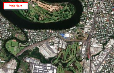

This is from my ArcGIS Pro v3.2.2, connected to ArcGIS Online, showing World Imagery basemap.
The map scale is 1:30,000

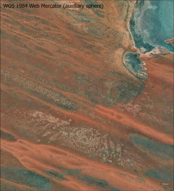

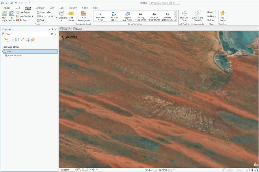

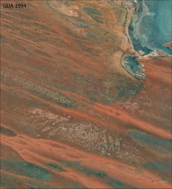

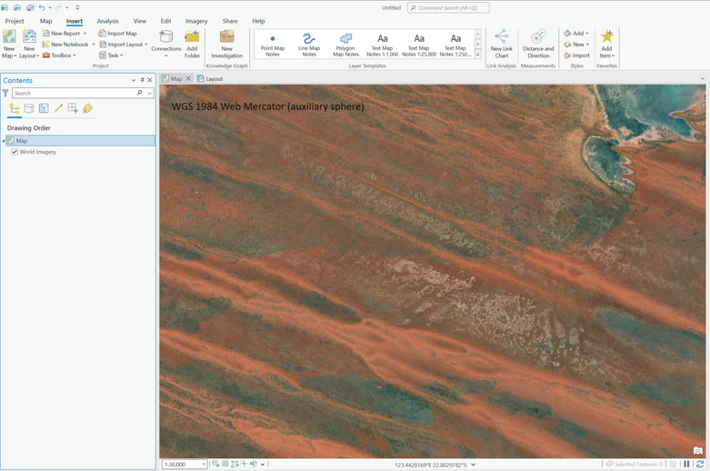

With a bit of further investigation it seems to potentially be some sort of display issue in pro. The difference in quality is drastic in the map viewer as well as the layout viewer. However when I output maps the resolution seems to rectify (see images below). So it's not really an issue for outputting maps, but rather just off putting when using WGS 1984 Web Mercator basemaps in any other coordinate system.
Map outputs:
Project screenshots:project_WGS_1984_merc.png
