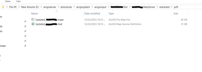

RanaDas
Hi @AndreaB_
It is not required to publish/overwrite the service again. During a publishing activity the publishing tool creates a MAP file and Service definition file in the in the arcgisinput directory. The service will continue to work even if the location (where you save the project) of the .aprx is not connected, as it has nothing to do with the file.
You will face issues with the service if the published service has referenced data which is stored in the network drive. If you have such services, you shall have to repoint and register the path of the referenced data in a location that is accessible by ArcGIS Server and has sufficient privilege to the Server Service account.
You can verify the path in installation directory of your ArcGIS Server.
Hope this helps.
