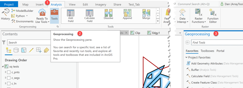

DanPatterson
MVP Esteemed Contributor
1, 2, 3
... sort of retired...
BryndaHatch
Open your Geoprocessing pane, by clicking the Analysis tab, then Tools.  Expand the Data Management toolbox.  Expand Raster.  Expand Raster Properties. Alternatively, just type in Calculate Statistics into the search box at the top where it says Find Tools.
