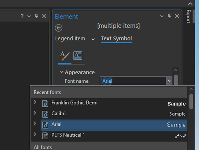

Is there a way to edit the Recent fonts list in the drop-down menu? A co-worker asked because his is getting really long. Is there a way to delete the list or refresh it?

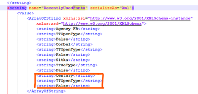

These are stored in the user.config file. Here is an example path: C:\Users\username\AppData\Roaming\Esri\ArcGISPro_StrongName_zvah3uykicxkwb5qgbiayac4t4a1cvw4\3.1.x.x
Open the file in a text editor, and search for RecentlyUsedFonts. Remove fonts that you no longer want in the list.
Save the file and restart ArcGIS Pro. The recent fonts list should be updated.
