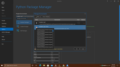

I receive the following error while trying to clone the environment
value error: check_hostname requires server_hostname
how can I solve this, before it was working, but now I do not know what could be the problem
JayantaPoddar
MVP Alum
Some are linking this issue with the existing version of urllib3 in ArcGIS Pro. Installing a lower (compatible) version of urllib3 in the clone environment seems to resolve the issue.
pip install urllib3==1.25.11
