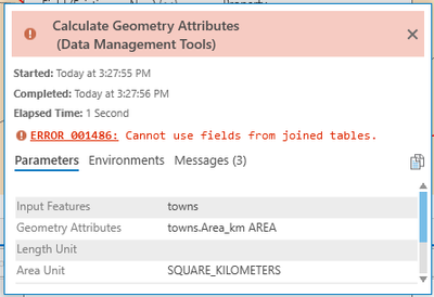

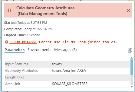

I have been receiving error 001486 whenever I try to calculate geometry on a joined table, even when the field that calculation is going into is associated with the shapefile I'm baseing my calculation on. See screenshot below:
As you can see, 'towns', my input features, is a shapefile:
And the 'Area_km' is part of that attribute table. The error implies that this is due to the field being in the joined table:

But this is not the case! My question is: Is Calculating Geometry always prevented with joined tables? If so, why?

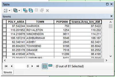

Working with Geometry on a joined table in ArcMap works fine:
So I remain curious about if this is the intended functionality, and if it is, why it changed from ArcMap.
