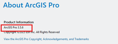

We have installed the 3.5.6 patch to address this vulnerability (https://www.esri.com/arcgis-blog/products/arcgis-pro/administration/arcgis-pro-3-6-1-patch) but the software version number (maybe in the registry) is not getting updated.  This causing issues with our IT Security compliance because when they scan our machines, they see 3.5.5 which is the vulnerable version.  We would like to find out if this is something that ESRI will be able to correct in a future 3.5.x update?
Images below - ArcGIS Pro shows 3.5.6 but Control Panel Uninstall programs still shows 3.5.5

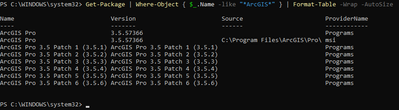

I have a machine running ArcGIS Pro 3.5. I have downloaded and installed patches 1 thru 6. I am seeing the same information in your screenshots. The screenshot of your control panel shows version 3.5.57366. 3.5 is the version of ArcGIS Pro and 57366 is the build number.
I use the following document to help me keep track of the patches, build numbers, and release dates for each ArcGIS Pro version:
https://support.esri.com/en-us/knowledge-base/faq-what-are-the-build-numbers-for-releases-of-arcgis-...
I refer to the instructions in the following document to find the installed ArcGIS patches on my computer:
https://support.esri.com/en-us/knowledge-base/find-installed-arcgis-patches-installed-on-machine-000...
When I run the command above, I see the following:

Thanks so much for the detailed reply.  I noticed that I had posted in an incorrect thread after posting, but the process of deleting my post was a bit much, so I let it stay.  My organization has contacted technical support for this issue.  I can confirm that the powershell command does show that I have patch 6 installed, just like your example above.  Thanks again for your input.
