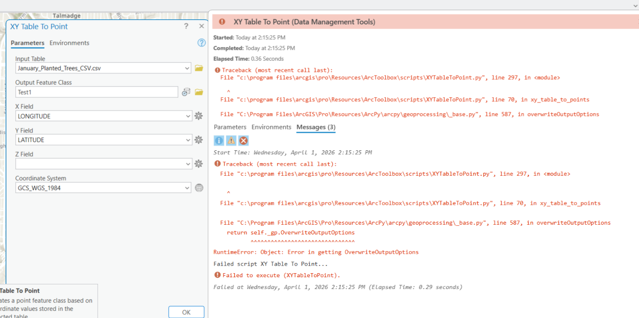

I am running into the strangest error message using the XY Table to Point GP tool.  I am on version 3.5.5
  • Traceback (most recent call last):
    File "c:\program files\arcgis\pro\Resources\ArcToolbox\scripts\XYTableToPoint.py", line 297, in <module>
    File "c:\program files\arcgis\pro\Resources\ArcToolbox\scripts\XYTableToPoint.py", line 70, in xy_table_to_points
    File "C:\Program Files\ArcGIS\Pro\Resources\ArcPy\arcpy\geoprocessing\_base.py", line 587, in overwriteOutputOptions
    return self._gp.OverwriteOutputOptions
    RuntimeError: Object: Error in getting OverwriteOutputOptions
It appears to be happening both on CVS files as well as a Esri Table saved to the GDB. I have tried different tables, and all give the same error.
Any tips or tricks would be greatly appreciated

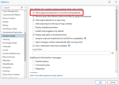

Hello @RyanBohan , the error message does mention the Overwrite option. What is yours set to ?
RyanBohan
Hi Chris, great thought, it’s embedded. I’ve also tried disabling and re-enabling it.

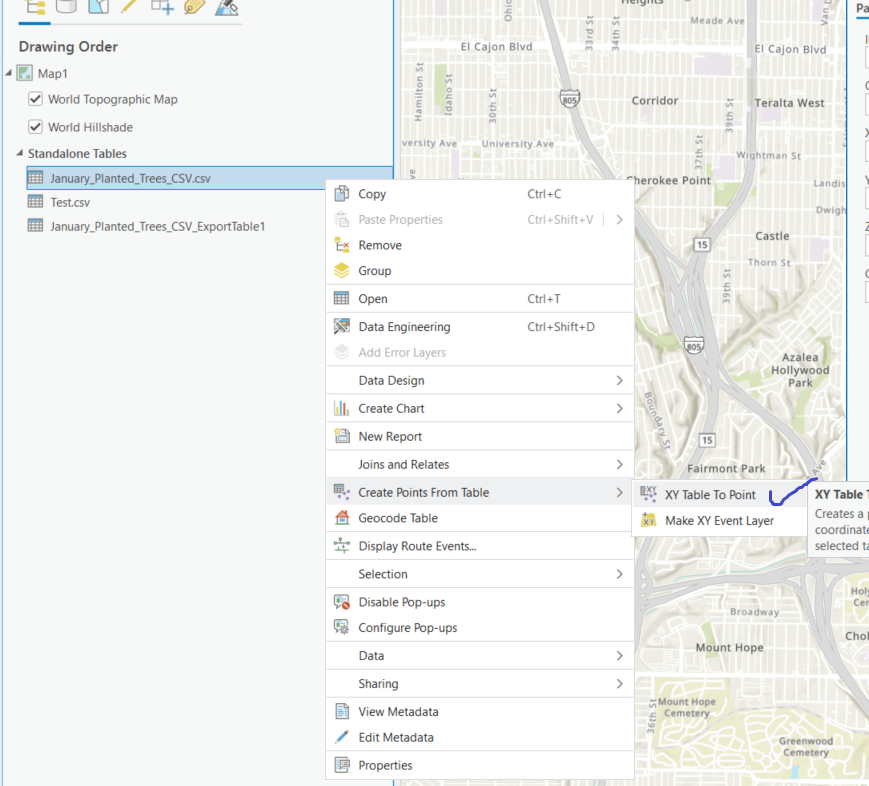

RyanBohan
It appears you can also do a two step process.
  • Make XY Event Layer (temp layer, not saved anywhere)
  • Export Feature.
