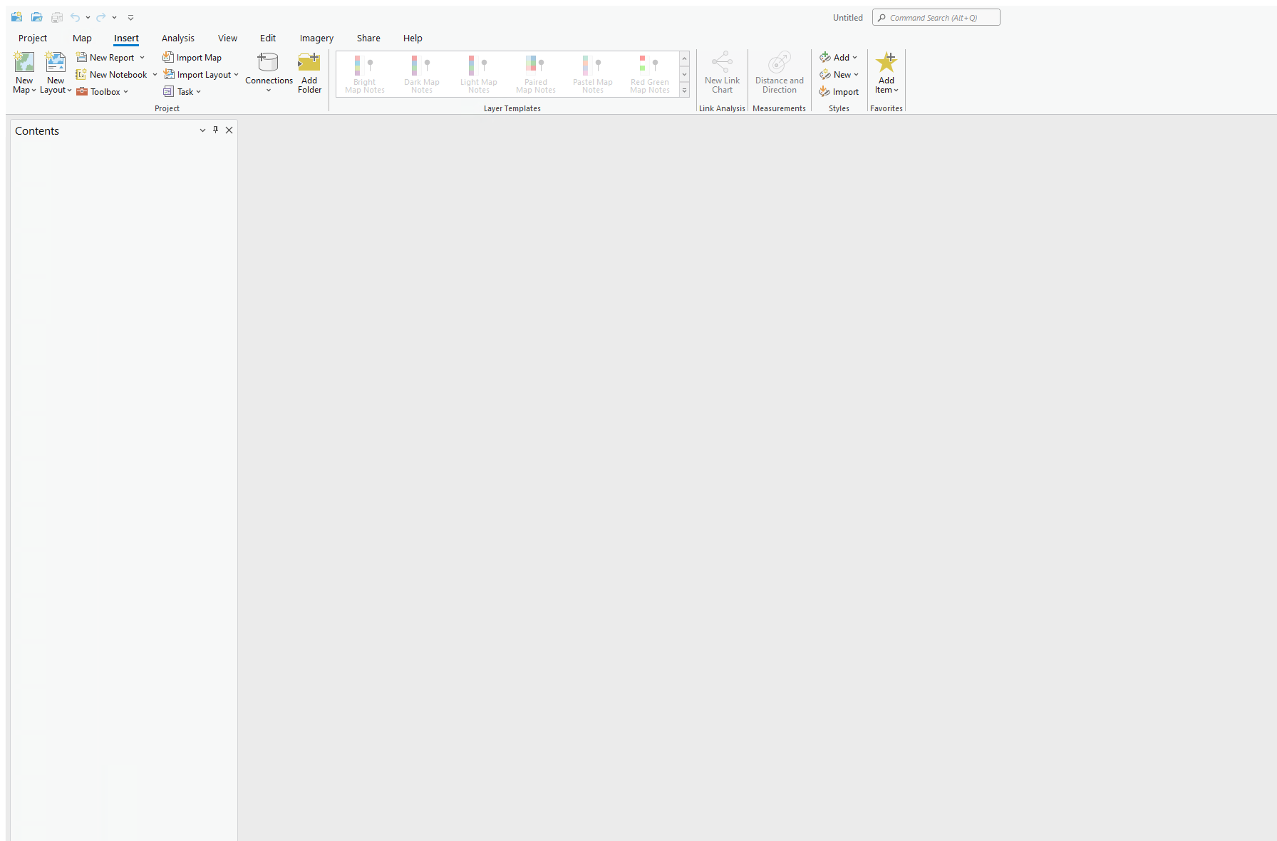

We are currently testing arcgis pro as an RDS application and have observed the following weird behaviour:
  • when one maximizes the RDS window, a border appears on the left and top - see screenshot (these borders are not present in the non-maximized window)
  • when clicking with the mouse, the clicks are offset slightly right and below the displayed mouse pointer (also here, only when the window is maximized).
Has anyone ideas how to solve this?
