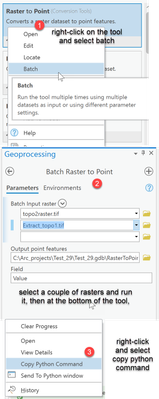

Right click the "Raster to Point" tool and select "Batch".

or you can create a temporary batch tool and edit it to do 100's.
Below is an example of just creating a batch for 2 rasters.
arcpy.Tmp.BatchRasterToPoint("topo2raster.tif;Extract_topo1.tif",
 \RasterToPoint_OutPointFeatures_%Name%",
 "Value")
# or
in_rasters = #  use ListRasters to get the semi-colon list above
gdb = r"C:\Arc_projects\Test_29\Test_29.gdb"
base_name = "Out_"
arcpy.Tmp.BatchRasterToPoint(in_rasters, f"{gdb}\\{base_name}_{%Name%}")
totally untested though
