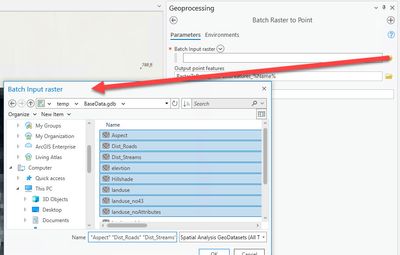

Rather than have all the rasters in the map, you can browse to the rasters and using shift click select first and last. This is much quicker than manually adding them.

Didn't seem to allow shift-click on multiple files. Would only accept one at a time. However, the suggestion of batching them via the right-click is much more efficient.

 click on the first raster and then shift click on the last raster
ScottFraser_Key-West
Just figured out how to do what you suggested about selecting multiple files. I'd been trying to select multiple files from within the "Batch Raster to Point" pane.
Then it dawned on me, multiple files can be selected in the "Contents" panel and dragged to the "Batch Raster to Point" pane and they'll be added to the batch. Ah ha!

Oh yeah... much easier. Wasn't aware there was a batch option hiding under the right-click.
