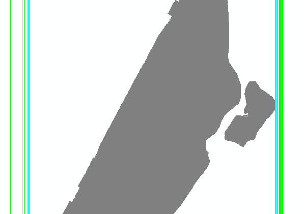

I use to be able to make Mosaic Datasets but now I can't. The geoprocessing goes fine and I receive no errors. However, when I view the two mosaic I made two this week using separate locations I get the same GRID values and the rasters I loaded are all grey with no texture.
Has anyone have an idea what step or option I am missing. I have recreated this issue in ArcMap and ArcGIS Pro 2.0.

I had to Calculate Statistics.

If you click on the raster with Identify does it show the values that you would expect? If so you may just need to futz with the symbology options on the Image layer. Depending on how the rasters should be symbolized it may be necessary to add a function to your mosaic.
Sorry I don't have a more immediate answer! I don't have a ton of raster/mosaic dataset experience.
