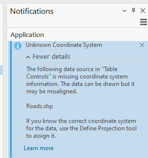

"Table Controls" is missing coordinate system information

What are "Table Controls?"  I've never seen or heard of this before.  Where can I find it?
Thanks in advance.

If this is a gdb that you received or a project package, it may be a history remnant
Geoprocessing history—ArcGIS Pro | Documentation
I would examine and clean up your geoprocessing history and any source gdb

Can you locate Roads.shp?  It is the file/layer that is missing a defined coordinate system.
Check your maps for the Roads.shp shapefile

Thanks for the reply.  I'm don't have a Roads shapefile in my project, everything is a Geodatabase Feature Class.  So, that and the term "Table Controls"  is confusing.

I like the suggestion of a past geoprocessing remnant causing the notification.
Anyway, the issue seems to have resolved itself.

I got a similar error about 'Table Controls', when packaging a project.  It says, "Map does not have layers" and the map is "Table Controls", but it's not a map I created and it's not in the list of maps in the project.  I cleared History but still get the error.  What is this map and how do I make it go away?  I was able to package this project before, but since then have added a script and a table, which I found in the 'Table Controls' map.  I did remove it, but still no go.
PaulCone2
Never mind -- I closed and reopened the project and now 'Table Controls' is gone, and am able to package the project.
