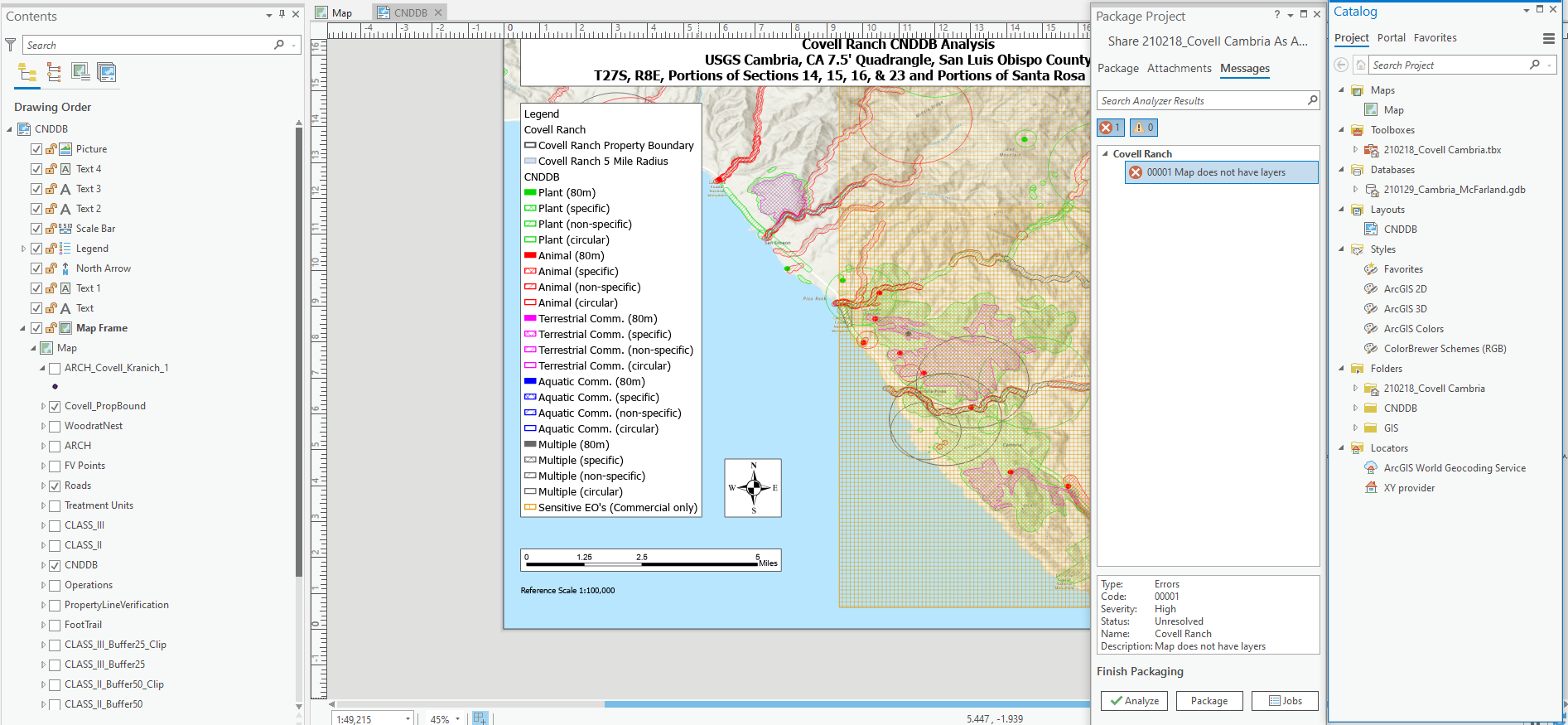

Attempting to package a project in ArcGIS Pro 2.7.1 and getting the 00001 Error: "Map does not have layers"
As the screenshot displays, I only have the one map in my catalog which obviously contains layers.
Anywhere else I should be looking for a hidden empty map?

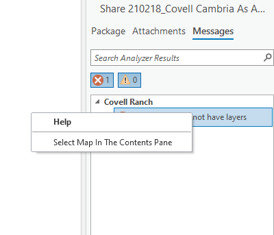

Right-click the error code:
Click "select map in the contents pane"

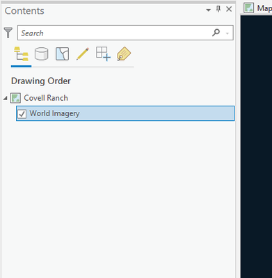

Add a simple basemap to the "Map" to resolve the empty layer issue

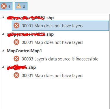

Same situation here, except the analyzer reported 3 maps without layer, along with another similar error.  As you can see, the maps are actually shapefiles.  They are not in my catalog, anywhere.  Classic ESRI stuff I grumble about and then feel guilty that I grumbled about later.  A waste of time.  If  you found any other options to pinpoint and fix problem, let me know.

Another thing to look out for - I have a map and a layout in my project template.  In the layout there was a map without layers.  I hadn't realized that and was only looking at the map.  Drove me crazy!
