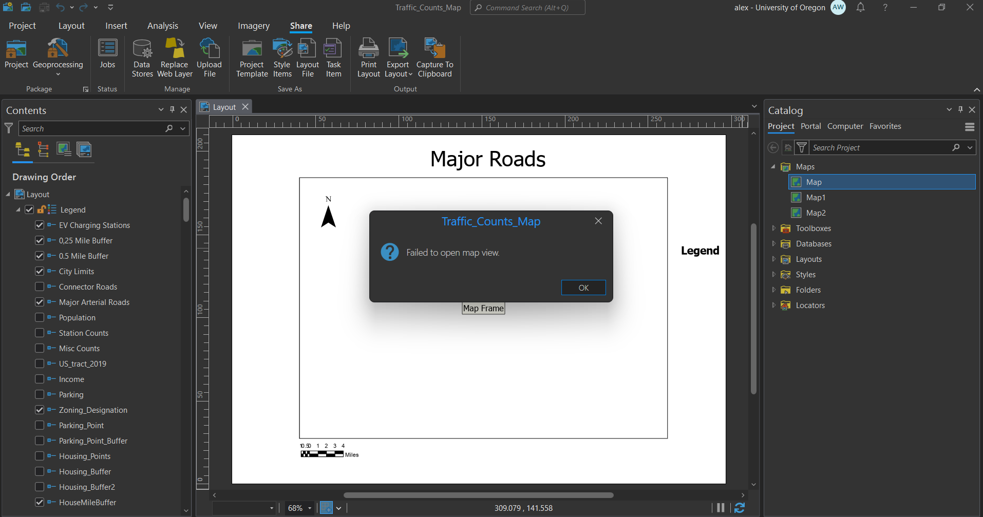

Hello users,
Today I opened up my project which I have spent around 40 hours on so far, and only my layouts were visible, but with no map data. My map was missing, but visible in the catalog pane. When I try to open the map from the catalog, I get the "Failed to open map view" error with no further explanation.

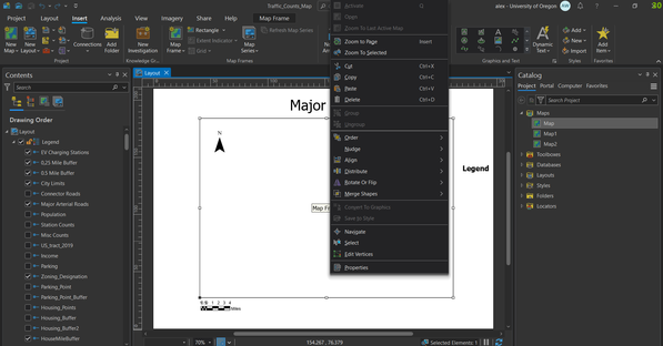

Are you able to activate your layout?
ajwright
I can't do anything with the layout. The legend isn't even populated which concerns me.

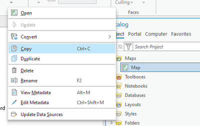

That's unfortunate. Have you tried "Copy" map from this project and "Paste" it to another?

Thanks for your comment. I tried this and the option to paste is greyed out.

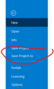

@ajwright Moreover, if the project is stored on network drive, try saving it to a local drive?
Use "Save Project As" to save it to a different location:
If this doesn't work, try creating a "Project Package" & save it locally:

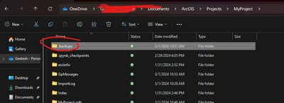

You can check backup folder , where your project is saved, maybe you can find something there:

ElizabethZizzamia1
I too just opened a project that I created last week (v3.2.0) and I got the message "Failed to open map view". I tried all of the tricks mentioned above with no luck. This is at least 10 hours of lost work. If there is not a bug reported, I will report it.
