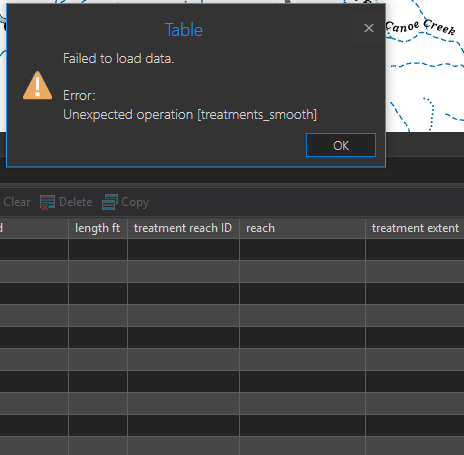

Hi,
I've gotten the "Failed to load data. Error: Unexpected operation []" error several times when I try to open an attribute in ArcGIS Pro v. 2.4.2 on Windows 10. I haven't been able to figure out any pattern to what is causing the error. I was able to load the attribute table for a dataset one minute and then a few minutes later I get the error when opening the table. I can select the feature and see the attributes in the pop-up dialog and the edit attribute panel. I have no pending edits, no definition query, or any other constraints on the data. Closing and reopening the project does not help.
Any thoughts or suggestions?
Thanks, Charlotte

After having this issue, I was able to work around it by the following method:
1. In the contents pane, right click the feature class with the attribute table issue, go to selection, and choose "Select All".
2. With everything selected, right click the feature class again, go to selection, and choose Make Layer From Selected Features".
3. Use the Feature Class to Geodatabase tool to save the new layer to your geodatabase.
4. Open the attribute table in the new feature class.
The new feature class opened for me without the error and without the rows I didn't want.  I deleted the old feature class from the GDB.  If I again tried to delete another row from the new feature class, the error message returned for the new feature class as well.  So I suggest that you first delete all of the records you don't want before using the workaround above to avoid having a bunch of the same features with different names in your GDB.
