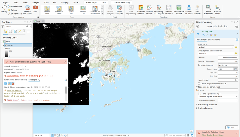

1.png2.pngHello,
I am attempting to use the "Area Solar Calculation" tool in ArcGIS, but I encounter an error whenever I run the tool with my DTM raster layer for a full day's calculation. I have verified that my raster values do not contain any negative values. Could someone please help me troubleshoot and resolve this issue?
ERROR 010067: Error in executing grid expression.
Thank you!

add *.tif to the output name since you appear to be directing the output to a folder.
The other error at the bottom is about the extent, so check the other parameters in the tool's settings
large rasters with other tools also fail with that error message so perhaps try a smaller area as a test

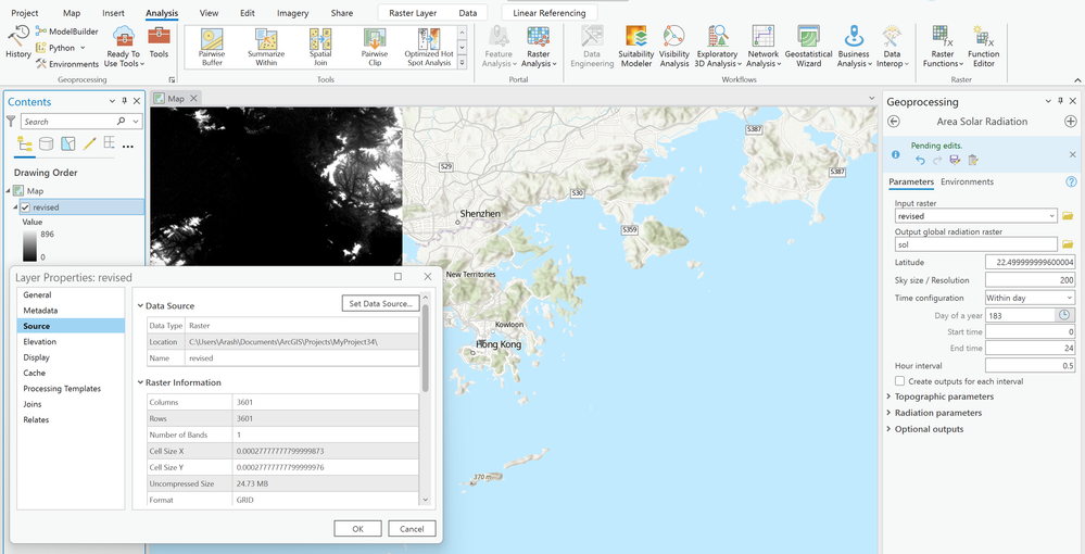

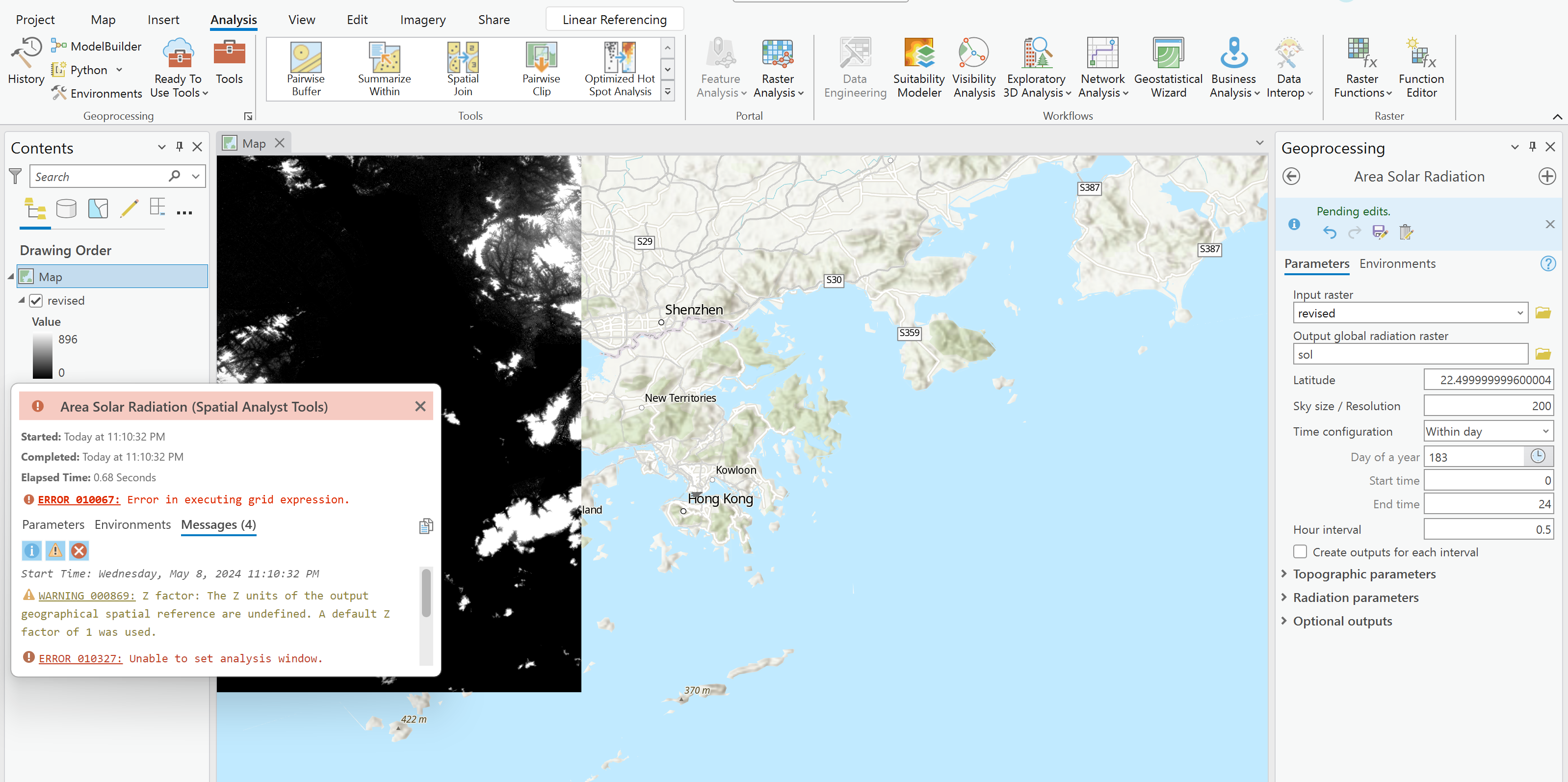

Thank you for your response. I've updated the output file name as suggested, but I'm still encountering the same error. Additionally, the raster file is not large, so I don't believe file size is contributing to the issue. Do you have any other possible solutions?

"unable to set analysis window"
Did you investigate that?
"not too large"  you may be ignoring temporary rasters that are being created during the process, so try a smaller area and examine the extent settings.
A similar error was found for the points solar radiation tool
BUG-000141252 for ArcGIS Pro (esri.com)
so try its suggestion
