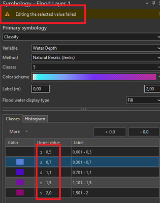

Hi, while attempting to adjust the values of the flood simulation visualization, the following error message appears continuously:
I just tried to change these values displayed in red, but every time I do, the error message shown above appears.
Does anyone else have the same problem or is able to reproduce this? I was hoping this issue would have been fixed in version 3.6.

Fabian_Schroeer
There is nothing explicit about this in the documentation.

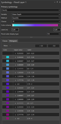

What surprises me is that when I set the visualization to “Classify” and change the method (e.g., to Quantile) and also increase the number of classes, the values in the table and in the visualization are adjusted without any problems. Only when I want to adjust the values manually do I get the error.
Even with the “Manual Interval” method, I get an error when I adjust the intervals manually.
