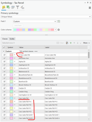

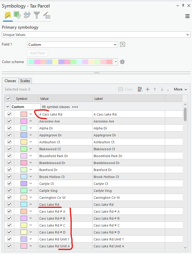

My symbology classes ended up like the picture below. The only issue I have is that some parcels along Cass Lake Rd have other values besides just the road name. Hence why I was trying to run a check looking to find and replace any arrays that contained all three values ["Cass"], ["Lake"], and ["Rd"].
I'm assuming the Includes function only looks for one single value out of an array, correct? Is there a way to check multiple values from an array? Better yet, is there a more efficient way to achieve this?

Ferreira
Ah-ha! That worked beautifully.
I wasn't aware that the Find function would work for this particular case. Thank you very much!
