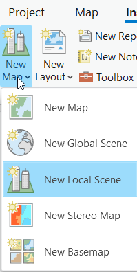

For your second question, you want to visualize the EMERGING_{ANALYSIS_VARIABLE}_HS_BIN. The 3rd column of the variable table indicates that particular variable is available in 3D. To visualize it, there are two steps:
1) Insert a NEW SCENE (select New Global Scene if it makes sense to show the curvature of the earth, otherwise select New Local Scene).
2) Run the Visualize Space Time Cube in 3D tool.
Then you can navigate around the 3D scene with your mouse.
