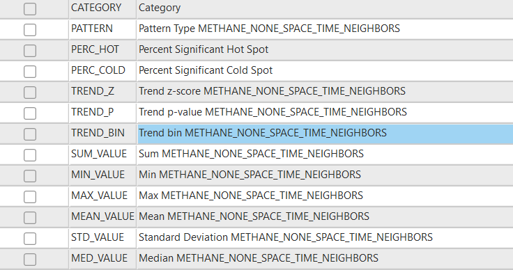

1) There are several variables in the Emerging hot Spot Analysis result (Output Features) as shown in the screenshot below. However, neither the tool documentation nor online resources give specific explanations for them. I am particularly confused about the variable TREND_BIN (trend bin). Is it the same one as the EMERGING_{ANALYSIS_VARIABLE}_TREND_BIN variable or the {ANALYSIS_VARIABLE}_TREND_BIN variable that are added back to the Input Space Time Cube as described in this page: https://pro.arcgis.com/en/pro-app/latest/tool-reference/space-time-pattern-mining/emerginghotspots.h...?
I don’t fully understand what this variable EMERGING_{ANALYSIS_VARIABLE}_TREND_BIN measures. Based on the documentation, “The result category used to classify each location as having a statistically significant upward or downward trend for hot/cold spot z-scores.” Are the z-scores from the Getis-Ord Gi* statistic? For statistically significant positive Gi* statistic z-scores, the larger the z-score is, the more intense the clustering of high values (hot spot). For statistically significant negative z-scores, the smaller the z-score is, the more intense the clustering of low values (cold spot). So, what does the upward or downward trend for those z-scores imply? How does it help to understand the trends in spatial clustering in the data?

Once all bins in the cube have been assessed (for the categories shown in the graphic above), it runs Mann-Kendal on the Gi* Z-Score values to get the trend for each location (column).
The PATTERN field in the EHSA output layer is one of potentially 17 different categories documented here. If you read the description for each category, you'll notice that to classify each location, the tool needs to know the count and percentage of significant bins and if they are hot or cold... and if they are at the top of the cube (most recent time steps) or not... And for most of the patterns this is enough, but to determine if the hot bins are intensifying or the cold bins are diminishing it computes Mann-Kendall on the Gi* z-score values. The TREND_Z, TREND_P, and TREND_BIN values in the EHSA output layer are those Mann-Kendall results.

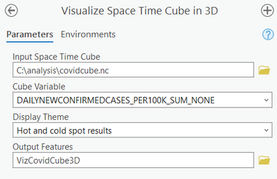

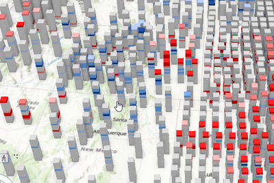

For your second question, you want to visualize the EMERGING_{ANALYSIS_VARIABLE}_HS_BIN. The 3rd column of the variable table indicates that particular variable is available in 3D. To visualize it, there are two steps:
1) Insert a NEW SCENE (select New Global Scene if it makes sense to show the curvature of the earth, otherwise select New Local Scene).
2) Run the Visualize Space Time Cube in 3D tool.
Then you can navigate around the 3D scene with your mouse.

Thank you very much for taking the time to replying to my question. With your help, I was able to visualize the EMERGING_{ANALYSIS_VARIABLE}_HS_BIN (my second question). Thank you!

The EMERGING_{ANALYSIS_VARIABLE}_HS_BIN variable is one of 7 values for each bin in the Space Time Cube and can be visualized in 3D:
3: Statistically significant clustering of high/large values at the 0.01 level
2: Statistically significant clustering of high/large values at the 0.05 level
1: Statistically significant clustering of high/large values at the 0.10 level
0: no statistically significant clustering
-1: Statistically significant clustering of low/small values at the 0.10 level
-2: Statistically significant clustering of low/small values at the 0.05 level
-3: Statistically significant clustering of low/small values at the 0.01 level
That variable does not include the Mann-Kendal trend information. The 2D output layer from Emerging Hot Spot Analysis (EHSA) shows the patterns and encapsulates the hot spot and trend information.
To me, it is difficult to draw conclusions from 3D maps (unless your data set is very small). The 2D maps (like the default output from the EHSA tool) seem more useful, but it really very much depends on the questions you're hoping to answer with your analysis.
