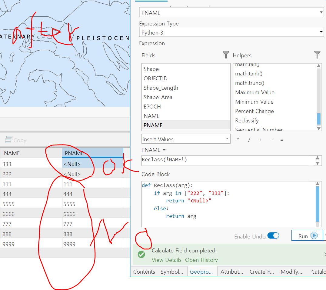

Hi~~~
def Reclass(arg):
    if arg in ["222", "333"]:
        return "<Null>"
    else:
        return arg
I want the results as shown below.
JoshuaBixby
MVP Esteemed Contributor
Do not return "<NULL>" because it will not set a field to SQL NULL, it will set a field to a text string that says "<NULL>".  If you want to set a field to SQL NULL, you want to return None.

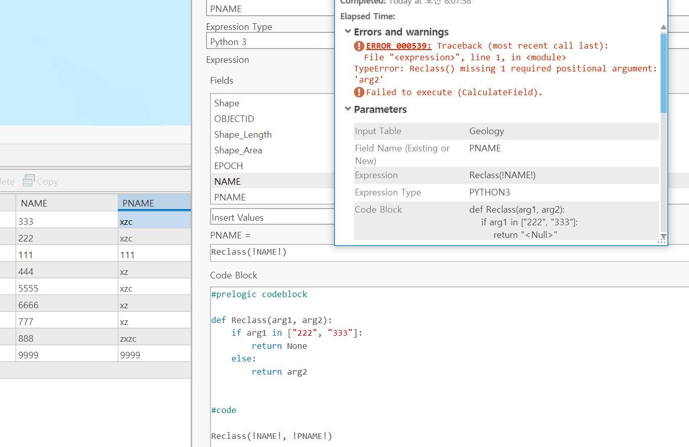

Nearly there, but you need to pass in 2 arguments.
#prelogic codeblock
def Reclass(arg1, arg2):
    if arg1 in ["222", "333"]:
        return "<Null>"
    else:
        return arg2
#code
Reclass(!NAME!, !PNAME!)

#prelogic codeblock
        return None
    else:
        return arg2
#code
