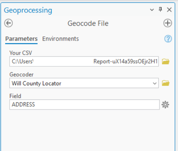

I'm attempting to create a python toolbox script that geocodes a CSV. It will be my version of the Geocode Addresses tool. What do I need to do to get the Field parameter to accept the 'ADDRESS' field of my CSV? Right now, the 3rd param accepts a Field datatype. I didn't see a good option in parameter controls either. If i run this tool as is I receive errors. Two of the errors mention needing an output parameter, which I'll get to. I'm assuming Error 000800 is referring to the Field parameter, but beyond that I don't really know. Maybe it's in the script itself.

I think it may be a problem with your field parameter. The geocode tool takes a FieldInfo Parameter (idk how those work) and you're feeding it either a Field (original post) or a value table.
Are you able to get the tool to run normally, outside of the toolbox?

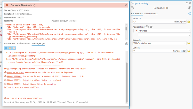

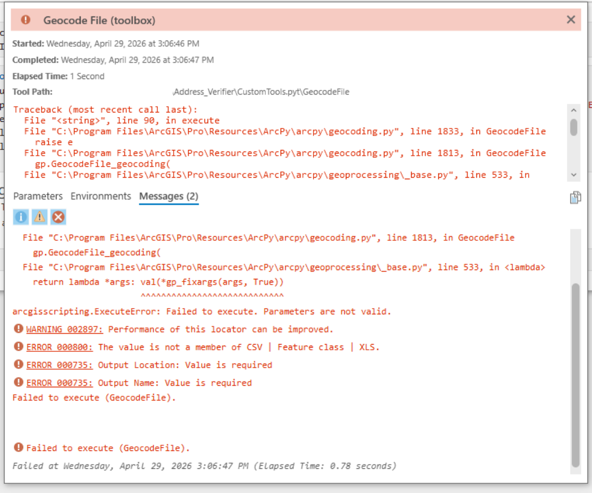

So, looking at those error messages, it looks like you have the following problems:
  1. Is your input CSV actually a CSV? GeocodeFile() doesn't think it is, and I can't see the file extension on your screenshots. You might want to add a filter to that parameter to ensure you get the right file type in there.
  2. The issue for output location and output name is that you're not providing a destination for the output file to GeocodeFile(). For example, in both code blocks you've attached, those parameters are commented out. They look like they're required.
    1. Using the output parameter the way you're doing now is a good idea, but you're going to have to split the location and the name before feeding them to GeocodeFile()
  3. You're also going to have problems using the first parameter for the output format, since that parameter takes specific values. I plugged in "CSV" below.

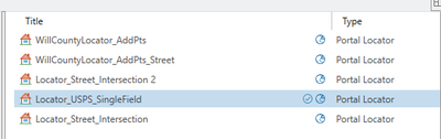

All in all those were good fixes. It's narrowed down to two errors tied to the GeocodeFile() function which have pretty unhelpful pages. Error 003346 and Error 002617
arcgisscripting.ExecuteError: ERROR 003346: Geocode File failed.
ERROR 002617: Batch Geocoding stopped with status esriJobFailed.
Failed to execute (GeocodeFile).
Things I've looked into regarding the geocoding errors:
1. Our locators are hosted on Enterprise Portal v. 11.3 which allows batch geocoding up to 1000 rows.
2. I've tested with different CSVs, different addresses and different field value formats.
3. The locator coordinate system is set for NAD_83.
4. I've been trying different locators and the tool has not ran with any of them while every time it has produced at least one of the two errors above. Error 002618 was also produced once too.
