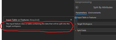

Hello,
I'm writing a Python Toolbox and would like to populate the hover pop-up with some information as shown for example in this image.
I'm struggling to find documentation on the code for this.  Any pointers would be appreciated.
Thank you,
Tyler

It looks like the Metadata in Arc is a custom XML format.  It might be in the project's temp file in the user APPDATA/Local at least that's where the HTML that gets generated and shows when you view metadata lives. I don't know if those temp folders are generated by project.
The Resources/Metadata/Stylesheets folder in Program Files/ArcGIS/Pro seems to hold the templates for generating these.
Arcpy can access metadata according to  https://pro.arcgis.com/en/pro-app/2.8/arcpy/metadata/metadata-class.htm

That info is maintained in the Metadata of the tool.   Right click on the script tool and choose "Edit Metadata."

@TrevisMartin et al, Thanks for the reply.  I was under the impression that a .pyt was self contained written entirely in Python.  So now you've got me scratching my head.   Where is the meta data stored and how can I access it programmatically?  Thx.  Tyler

Ok, yeah, after opening the metadata the xml's were created and now I see what's going on.  So, if I want to share a python toolbox I'll need to share the xml's as well or wrap it up in a gdkx.  For some reason I had recalled that it was all captured in the pyt, alas not.
