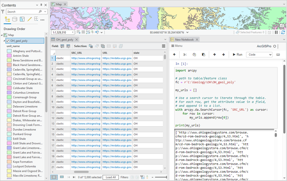

I am using arcpro 3.3 and I have an attribute table with a field with hyperlinks to download files from the internet.  Is there a tool or script to run to automatically do this?

So, to do the downloading automatically, I'd use a search cursor to iterate over the table and get the values from the URL field in a list.
https://pro.arcgis.com/en/pro-app/latest/arcpy/data-access/searchcursor-class.htm
You could make a list, my_urls, for example, and for each cycle of the search cursor append the URL string to the list.
https://www.w3schools.com/python/python_lists_add.asp
It would look something like this:
import arcpy
# path to table/feature class
fc = r'C:\Geology\OH\OH_geol_poly'
my_urls = []
# Use a search cursor to iterate through the table.
# For each row, get the attribute value in a field,
# and append it to a list.
with arcpy.da.SearchCursor(fc, 'SRC_URL') as cursor:
    for row in cursor:
        my_urls.append(row[0])
print(my_urls)
Once you have the URLs as a list, use Python to download them to your preferred location. There's an example here:
https://towardsdatascience.com/use-python-to-download-multiple-files-or-urls-in-parallel-1759da9d653...
Best,
Bob

Are you trying to download every linked item from each row of your table? Or are you trying to format hyperlinks so a pop-up will allow the user to download a selected link?
Best,
Bob
JonPeroff
Hi Bob,
Happy Canada Day!
I am trying to download from every linked item in a row.  The URL is in one field of the attribute table and there are many rows, too many to download one at a time.
Thanks,
Jon

I apologize for the late response.  I thought I would get a notification.
I did finally get a script to work and it's very similar to yours.  So thank you for that.  I just need to figure out how to download and mosaic them together in the one script.  Another topic for another day!
