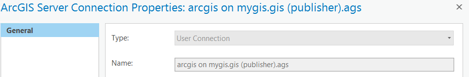

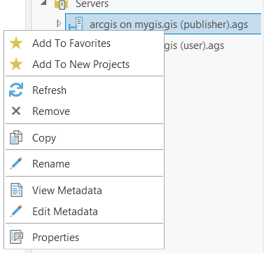

I can't publish to ArcGIS stand-alone server from ArcGIS Pro.
- I can't see the publish option.
- I can't change the connection type to Admin or Publisher... it is dimmed.

Based on the screenshots, it seems that you are connected as a user, not a publisher: https://pro.arcgis.com/en/pro-app/3.1/help/projects/connect-to-a-gis-server.htm#ESRI_SECTION1_CC2062...
Try to make a connection as a publisher.
If possible for testing, can you make an "admin" connection?

I am connected with the siteadmin. I also tried connecting with another administrator account but got the same result.

Weird that I do not see any options for publishing?
