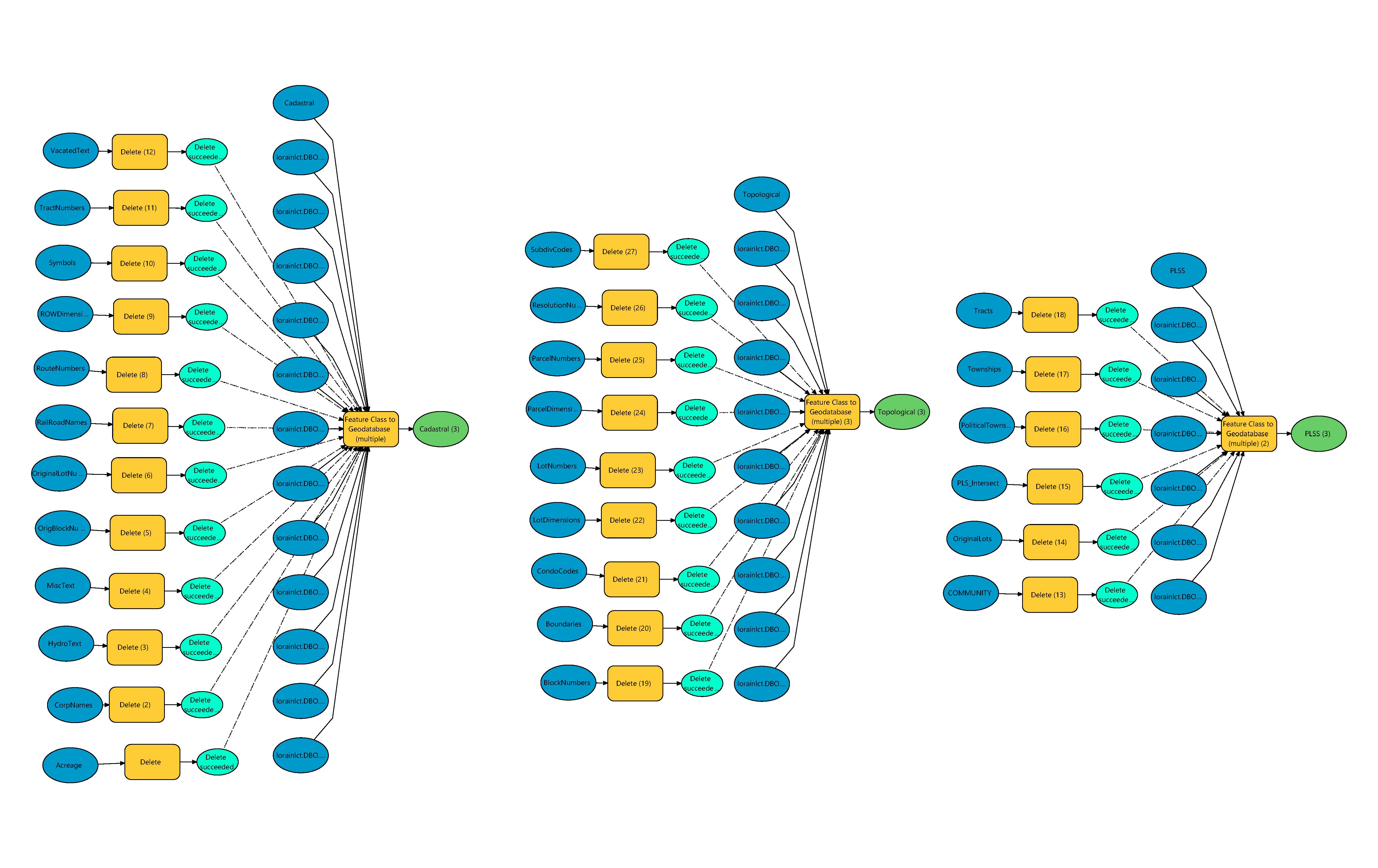

Hoping to get help with model builder and a model I built.  I know there has to be an easier setup then the gigantic model I have.  Overall I'm trying to use the feature to feature tool to copy feature classes from one gdb to another and I'm doing this on a nightly basis.
Before that copy occurs, I need to delete the existing feature classes in the gdb that will be copied to.  I understand there is an option to overwrite existing features but it doesn't work and I keep getting a copied feature class with '_1' after the name....so 'parcelnum_1' since there's already a 'parcelnum' in there from previous update.
The model I built is extremely big and redundant, but that's from lack of experience and knowledge using model builder.  So again, what I need to do is copy feature class to feature class but delete the existing ones in the copy to gdb before the new ones are copied.
Please see attached photo of what I created and any help to streamline this process would be appreciated.  I have 3 different datasets with several feature classes in each.
I set it up to copy all the feature classes to gdb but before that, as a precondition, that each feature class is deleted first and than it copies.  Everything works fine, just wanting to see if there's an easier model process to follow.  Thanks for any help/guidance.

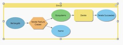

The first thing I did was create a new model (submodel) using the Iterate Feature Classes iterator.  I double clicked the Iterate Feature Class iterator and set the Workspace or Feature Dataset parameter to my fGBD that has the FC's I wish to delete. I set the Wildcard to an asterisk for all FC's.  I connected the green oval to the Delete GP tool.  Select all the graphical items in the model, right-click and click Group from the Context menu.  Next right-click again and select Save as Model and save it in your Custom Toolbox. (see Image 1)

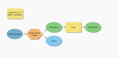

Next, create a new model.  Drag and drop the newly created submodel onto the new model canvas.  I then added the Iterate Feature Classes iterator.  Double-click the Iterate Feature Classes iterator.  For Workspace or Feature Dataset parameter, navigate to your other GDB that has the new data to copy into the other GDB.  I set the wildcard parameter again with an asterisk for all FC's.
Next add the Copy GP tool to your model and connect the green oval to the Copy GP tool. (See Image 2)

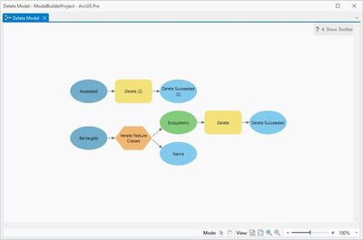

1.  The first model is the Delete Model.  It deletes all feature classes and feature datasets. The standalone Delete GP tool is hardcoded to delete the FDS in the target. See image below.

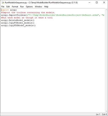

4.  Next I created a simple Python script that calls the models sequentially.  See image below:
Lastly, in the project toolbox, I right-clicked on the toolbox and selected Script and fill out the tabs to point to the Python script.  This is now a Python Script tool you can rerun regularly.  I've tested it many times and there are no _1's or _2's present.  One last thing to double check is your Project->Options->Geoprocessing tab for the "Allow geoprocessing tools to overwrite existing datasets" is checked on.
