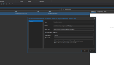

I added the server to the project and opened Catalog View, right clicked on the server and clicked on properties to change the user type.  I read in another thread that you had to be an admin to publish and publishing is not an option when you right click.  I am an admin.

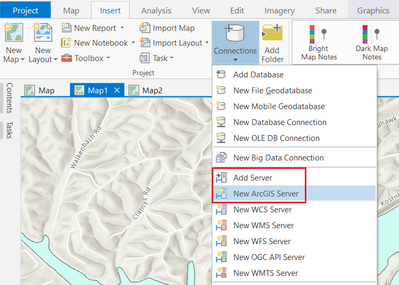

Please follow the steps in order.
Use "Add Server" for adding an existing connection file. Else use "New ArcGIS Server" for creating a new connection file.

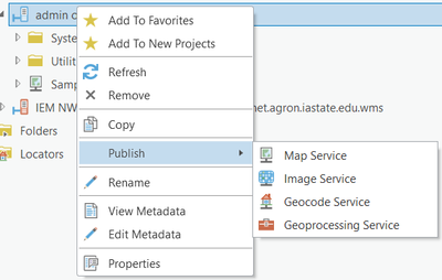

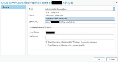

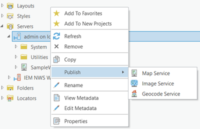

For a standalone server (not federated), I am able to change the Connection Type from Server's Properties (after the connection is created).
With a Publisher Connection, I can publish Map Service, Image Service and Geocode Service.
With an Administrator Connection, I can additionally publish Geoprocessing Service as well.

That is the steps I have followed and I still am unable to change the user type.  I have always been able to publish from ArcMap, I don't know if that is relevant to this or not.  What is the difference between a Standalone and a Federated server?

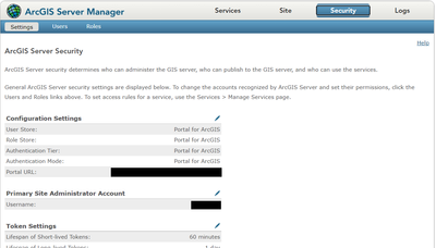

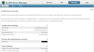

Configurations for ArcGIS Server
If you have access to ArcGIS Server Manager, check the following page
Login to ArcGIS Server Manager > Security > Settings
A stand-alone Server should look similar to this (if using built-in users)
A federated Server should look similar to this (this one is also a hosting server)
*NOTE: If your ArcGIS Server site is federated, you can still use the same process to publish from ArcMap, but you can't publish directly from ArcGIS Pro.

by Anonymous User
Not applicable
All of my settings are exactly the same as the ones in the Standalone picture.  So at least I know I should have the capability.
