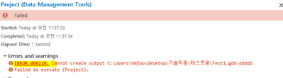

At the last step of the process, I got an error "Error 00210" which is related with data locking, incorrect path, and limited access rights. The thing I am so confused with this error and don't know where to start fix is that I solved all those three issues.
I swear there's only this aspx using the data (no data locking), path works fine after tested with exporting another data to the same path, and work with the admin account.
Did it occur since I project the feature class into the same spatial reference? But, when I tried projecting another sample feature class to the same spatial reference it worked very fine.

output names must differ from inputs
check your environment settings to ensure that you allow for overwriting of existing datasets, otherwise if an output already exists (that is, you try to use the same name), it will fail

Did you tried to change the output location when you project this data?
The error could be related to this specific feature layer, it might be that one or more of the columns are not valid (reserved word or too many characters).
It would be a good idea If you could show me your model and the data that you're trying to process.
