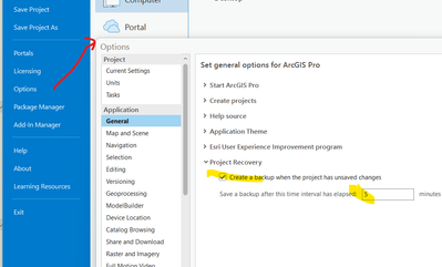

I know this does not fix your network problems, but certainly it sounds like autosave is making this worse for you.
Maybe you should turn it off until your network problems are addressed to see if it helps.
Go into the "Project" screen and go to "Options". Under  "Application" click "General" and expand "Project Recovery". There you can choose how often a backup is created and whether or not to create one.
