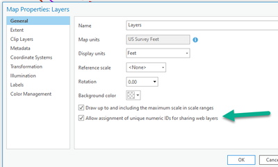

No idea either.  But for the copy/paste of layers, if you  enable the "Allow assignment of unique numeric IDs for sharing web layer" before you paste it, it will automatically update the layer ID to a unique value.  Without this checked, it will retain the value of the layer being copied.
