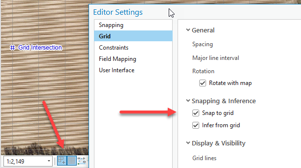

You say it is snapping without any other layers?  Do you by chance have the grid turned on with snapping?

Thanks for the idea, Rhett. No I do not.
