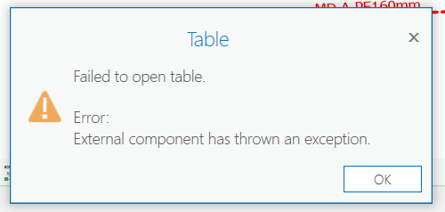

3. Iteration Over Error Layers: I'm experiencing problems when attempting to iterate over the error layers. I can't even open the error layers on our enterprise environment, getting an error that looks something like this:
Furthermore, the `GetCount` tool doesn't seem to accept the error layer names as expected. Does anyone have suggestions on how I can count the rows in error layers through an arcpy script?
