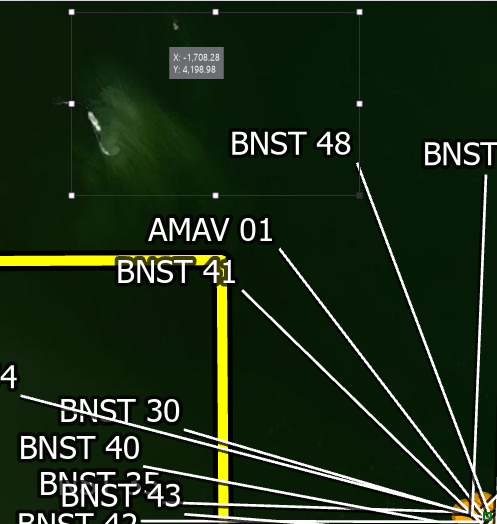

Is anyone else experiencing bizarre behavior when repositioning labels converted to graphics since the ArcGIS Pro 3.2 update?
We are finding that it's no longer easy to drag a label with a leader line to a new position. The selection box containing the label, line, and anchor changes shape in unexpected ways, and the label often does not remain where we move it but instead jumps somewhere else when we release it. It's making an already time-consuming task take ten times longer.

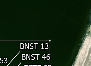

Update for anyone else suffering... it seems to drop the label wherever the lower left handle on the selection box is (maybe only if labels are left-justified).
So dropping the "BNST 13" label here...

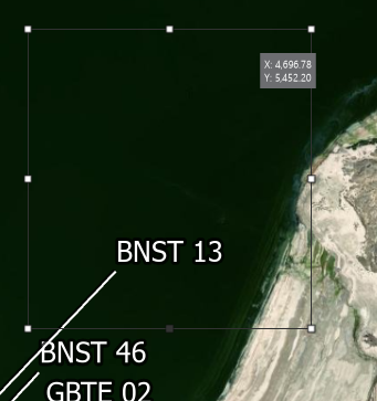

...will place it here:
Knowing the pattern is helping.
